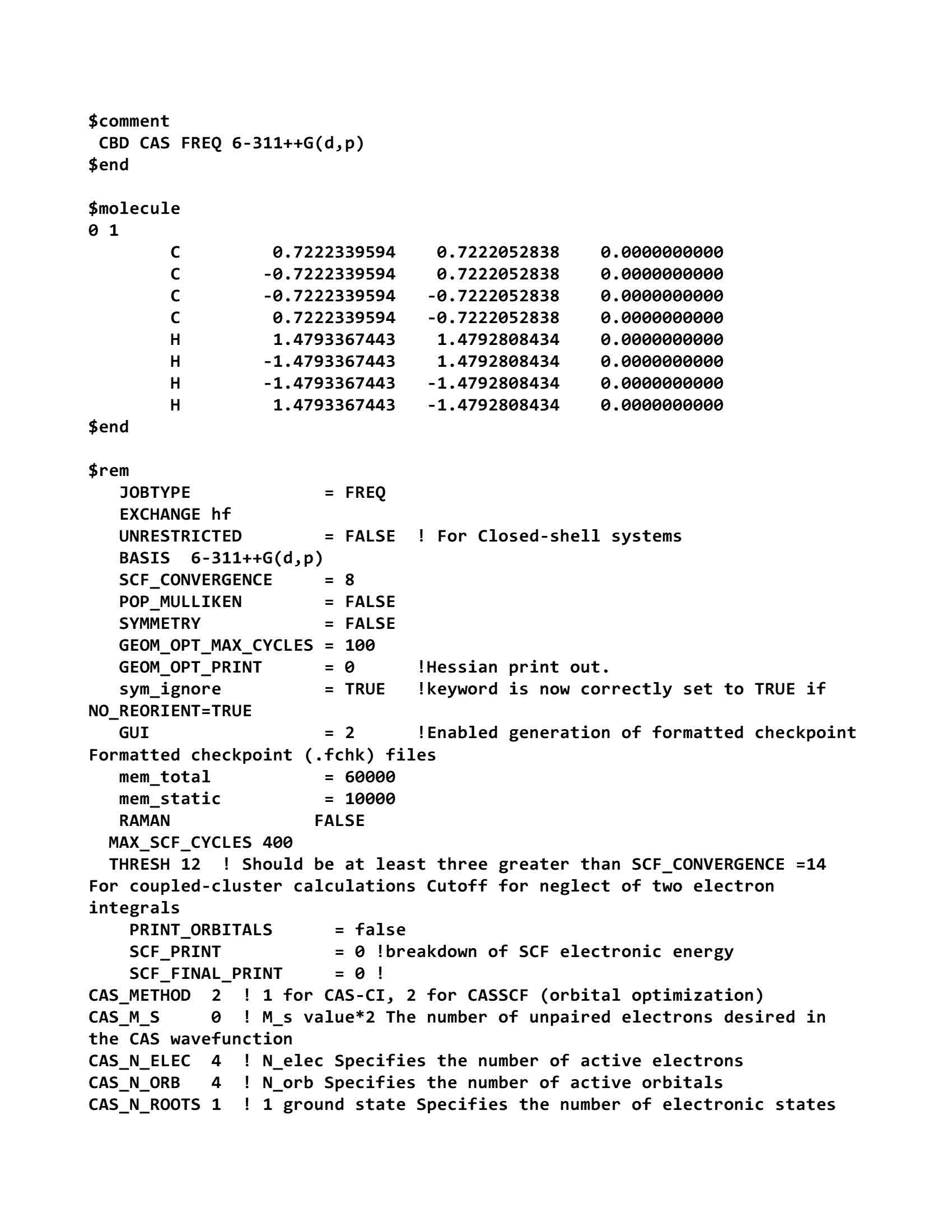

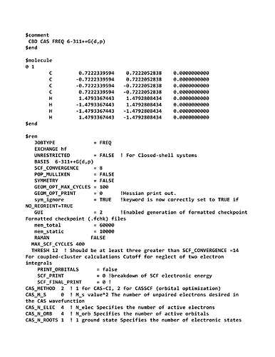

Hi there,

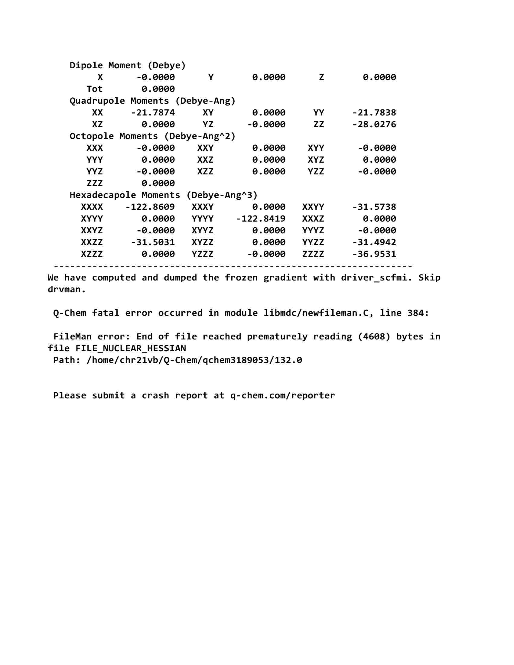

What could be yje reason for the error:
Q-Chem fatal error occurred in module libmdc/newfileman.C, line 384:
FileMan error: End of file reached prematurely reading (4608) bytes in file FILE_NUCLEAR_HESSIAN
Path: /home/Q-Chem/qchem3189053/132.0
$comment
CBD CAS FREQ 6-311++G(d,p)
C 0.7222339594 0.7222052838 0.0000000000
C -0.7222339594 0.7222052838 0.0000000000
C -0.7222339594 -0.7222052838 0.0000000000
C 0.7222339594 -0.7222052838 0.0000000000
H 1.4793367443 1.4792808434 0.0000000000
H -1.4793367443 1.4792808434 0.0000000000
H -1.4793367443 -1.4792808434 0.0000000000
H 1.4793367443 -1.4792808434 0.0000000000
JOBTYPE = FREQ
EXCHANGE hf
UNRESTRICTED = FALSE ! For Closed-shell systems
BASIS 6-311++G(d,p)
SCF_CONVERGENCE = 8
POP_MULLIKEN = FALSE
SYMMETRY = FALSE
GEOM_OPT_MAX_CYCLES = 100
GEOM_OPT_PRINT = 0 !Hessian print out.
sym_ignore = TRUE !keyword is now correctly set to TRUE if NO_REORIENT=TRUE
GUI = 2 !Enabled generation of formatted checkpoint Formatted checkpoint (.fchk) files
mem_total = 60000
mem_static = 10000
RAMAN FALSE
MAX_SCF_CYCLES 400
THRESH 12 ! Should be at least three greater than SCF_CONVERGENCE =14 For coupled-cluster calculations Cutoff for neglect of two electron integrals
PRINT_ORBITALS = false
SCF_PRINT = 0 !breakdown of SCF electronic energy
SCF_FINAL_PRINT = 0 !
CAS_METHOD 2 ! 1 for CAS-CI, 2 for CASSCF (orbital optimization)
CAS_M_S 0 ! M_s value*2 The number of unpaired electrons desired in the CAS wavefunction
CAS_N_ELEC 4 ! N_elec Specifies the number of active electrons
CAS_N_ORB 4 ! N_orb Specifies the number of active orbitals
CAS_N_ROOTS 1 ! 1 ground state Specifies the number of electronic states to determine
CAS_THRESH 12 ! N for a threshold of 10^N. Specifies the threshold for matrix elements to be included in the CAS Hamiltonian
CAS_SAVE_NAT_ORBS FALSE ! Save the CAS natural orbitals in place of the reference orbitals
MAX_CASSCF_CYCLES 400 !Maximum number of orbital optimization cycles for CASSCF
CAS_USE_RI FALSE !Compute 2-electron integrals analytically. Analytic integrals are more accurate
CAS_DAVIDSON_TOL 5 ! Default. Specifies the tolerance for the Davidson solver used in CAS
CAS_DAVIDSON_MAXVECTORS 10 ! Default
CAS_SOLVER 1 ! 2=ASCI, 1=Olsen, 0=naive. 1 CAS-CI/CASSCF
TRUNC_CI_LEVEL 0 ! default
ASCI_DIAG 2 ! Specifies the diagonalization procedure. Use 2 for best trade-off of speed and memory usage. Arma Sparse=0, Davidson=1, Eigen Sparse=2
SCF_ALGORITHM diis_gdm !Pulay DIIS+then later switch to geometric direct minimizationAlgorithm used for converging the SCF.
!For systems with small HOMO-LUMO gaps and DIIS fails to converge, LS_DIIS could help
SCF_GUESS = CORE
Input and the part of output file are attached
Thank you
Well, please give the context (CASSCF ground state) of what you are trying to calculate along with the minimal input for which you see this error using the preformatted text option (</>). Please remove unnecessary keywords related to geometry optimization in your REM. You can try computing the frequencies with finite difference using the “IDERIV = 1” setting and verify the results.
There’s a lot going on here, as Kaushik mentioned. For one thing, your comment that
is not corrected. What you’re actually doing there is turning on ROHF, which is probably not what you want for a closed-shell system.
The deeper problem, which may be a bug, is that this calculation appears to behave as if we have analytic Hessians for CASSCF, which will be news to me if true. There’s no message at the top about finite-difference Hessians.
I would do as Kaushik suggests and choose a minimal sample, set IDERIV explicitly and see what happens.

I think that the bug you have found is that the CASSCF analytic Hessian is not available but for some reason Q-Chem does not automatically switch to finite-difference. I will report this.

Finally, IDERIV = 1 solved the problem and the frequency job was finished successfully. So thank you again. Yes, I was a bit confused fo the situation that the lack of this option resulted the end of Hessian file reading error.
