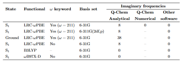

As a further update, we did some small testing. We tried:
  • Different basis sets (6-31G and 6-311G(2df,p))
  • Both GS and excited state calculations
  • With and without the omega keyword
  • Different functionals (B3LYP and ωB97X-D)
The only case where we obtained 0 imaginary frequencies (consistent with the other software) was when we changed the functional.
which functional gives you 0 imag freqs?
The functionals that give 0 imaginary frequencies are b3lyp and ωB97x-D.
To be more clear on what we tested and the results:
All geometry optimizations were performed in Q-Chem. For each optimized structure, the vibrational frequencies were subsequently calculated using the analytical Hessian in Q-Chem and another quantum-chemistry software. The numerical Hessian in Q-Chem was computed for one of the structures.
