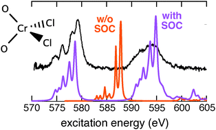

FYI, this is feasible using TD-DFT, which allows for arbitrary active spaces amongst the occupied MOs, so can implement the CVS approach that you need. For example, used here recently for L-edge XAS:
