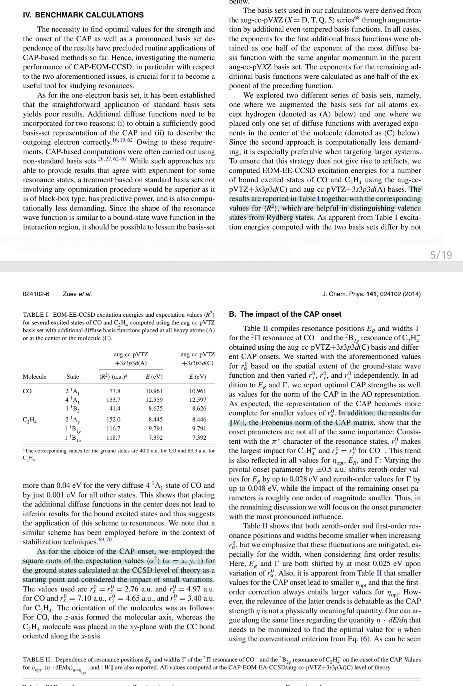

https://doi.org/10.1063/1.4885056 this is paper I’m referring.
Can anyone tell how to get <R^2>, <alpha^2> and frobenius norm in QChem ?
