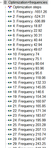

I’m trying to calculate the vibrational frequencies of excited state(T1) for my Titanium complex and I couldn’t get rid of the imaginary frequency.

Result
Tighten the thresholds (e.g., THRESH=14) and the geometry optimization stopping criteria (GEOM_OPT_TOL_*, where * = ENERGY, GRADIENT, or DISPLACEMENT). Perhaps also tighten the quadrature grid (e.g., XC_GRID = 3). If it still persists, use the normal mode information to displace along the mode with the largest imaginary frequency.
