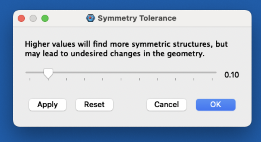

Ok, good. Just FYI, there is a symmetry tolerance setting in IQmol (in the menus under Build ==> Set Symmetry Tolerance).
Yeah. It appears that the symmetry detection in IQmol will detect C2v correctly but only if you selected the correct tolerance threshold on the first time you hit “apply” otherwise the program detects another symmetry AND changes the geometry (the coordinates) according to the wrongly identified symmetry, which you wouldn’t want before you get the program’s symmetry recognition tool to lock on to the correct symmetry. I believe Avogadro doesn’t change the coordinates when adjusting the symmetry tolerance variable.
